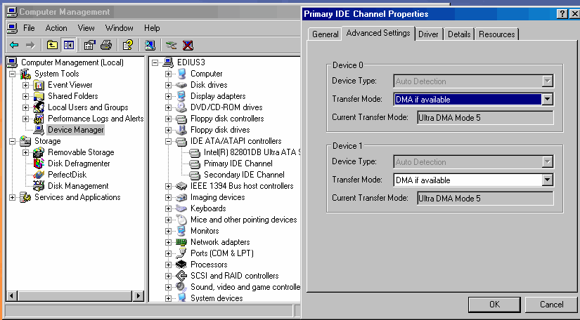

          also, what drive is used for PCE? IDE? SATA? SCSI?
          if IDE, is it possible it jumped into PIO mode, this would explain your problem with PCE

                make sure C drive primary channel is on UDMA5
                  Primaryy IDE Channel properties :
                  Device 0 : UDMA5
                  Device 1 : UDMA5

                      that is perfect, back to drawing board

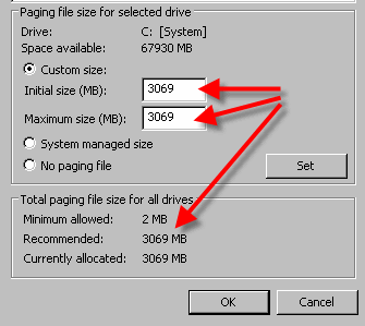

                      how much Ram do you have and what is the min and max size of the swap file?
                      I always set min and max the same according to what is recommended
