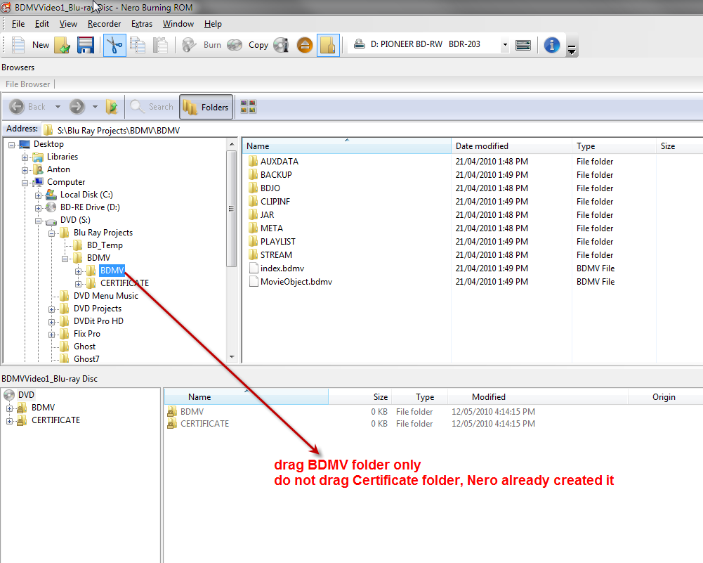

    The Image has everything, when you burn that image make sure you burn that other folder that it created also.
      Hi Al
      Rename the folder BDMV to any name otherwise it will be written over next time unless you use a different location. The other folder is called BD temp i don think you need that one You only want the biggest folder, inside the BDMV folder there are several folders keep all of these Look in the stream folder it contains loads of m2ts files there is one of which will be about 20gb that is the one with the video all the others are smaller about 3mb those are your chapters You could copy the new renamed folder to a BD Data Disk if you want to keep the files and free up space

          the folders to burn are BDMV and Certificate, it includes the menus

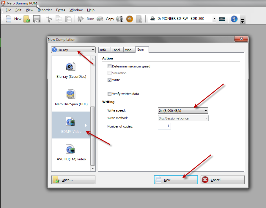

              when burning with Nero 10, it already places BDMV and Certificate folder for you if you choose the BDMV video preset

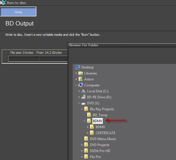

              if burning with Edius Disk Burner, browse for the BDMV main folder which holds the BDMV and Certificate folder and that is all you need to do

                      Have you made the Blu-ray compilation with Edius yet? in Edius diskburner with Edius open, click burn disk but first untick the burn to disk, but tick export as image, this means it will be compiled to a hard disk location of your choice
                      then at any time with Edius closed, open disk burner and browse for the folder created in the above step
                      however, before you burn, test the BDMV with Total Media 3 to make sure the menu works fine

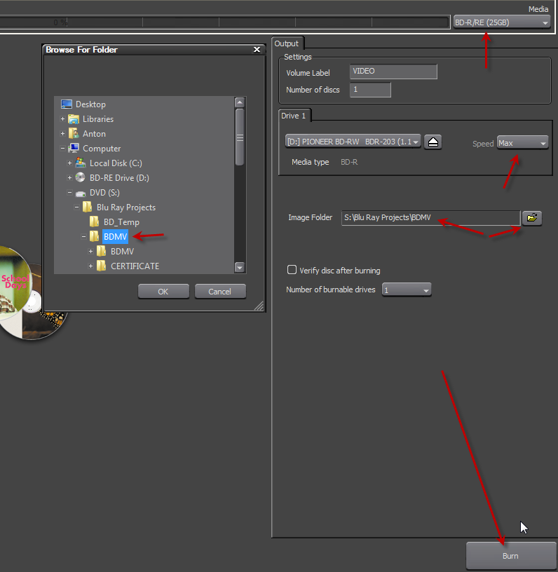

                          insert BD-R disk in burner and wait 1 minute
                          open Edius Disk burner and load the BDMV folder that contains BDMV and Certificate, follow screenshot

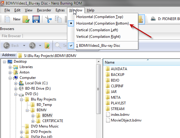

                          with Nero 10 Burning Rom, follow screenshots

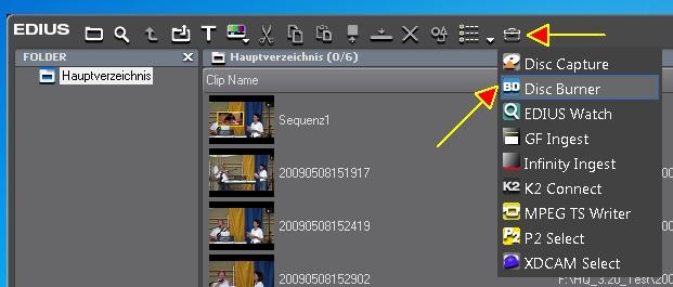

                            open Edius Disk burner = Bin ==> Tools ==> Disk Burner
                            this tool named "Disk Burner " is not described in the manual / helpfile
                            it is simple forgotten....

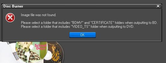

                              the only hint from GV, what is to do, is a warning pop-up , if you select the false folder
                              or you read (aside from GV-Manuals) Antons forum-posting's and websites...... ;-)
