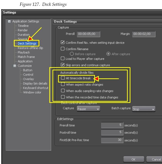

    I have been converting VHS and DV tapes to DVD without issue. A setting seems to have changed in Edius that I am not aware of, because after a year of converting tapes, I am seeing a new behavior when capturing my playback source: Every time Sync breaks on the source tape, Edius stops capturing.
    i.e. on a home video, when the user stops recording and there is the 2-3 seconds of "snow" before the user records something new, the Edius capture process stops upon reaching the "snow."
    I've been capturing entire tapes with Sync breaks for a year without issue. What did I toggle to create this new behavior?
    Thanks!
    EDIUS51_User_Reference_Guide_ENG.pdf
    on page 143, in a better english as mine.....
