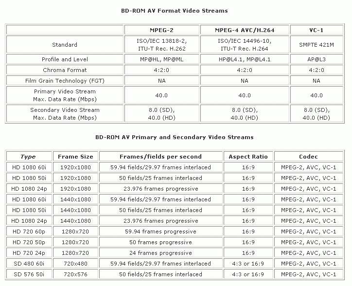

          it is not a Edius issue ==> Edius projects are conform with "video standards"
          23,976 is a BD conform format
          source: http://www.emedialive.com/articles/r...leid=11397#iif
          friendly greetings from the "inhouse-librarian" ....located in CentralEurope
            Thanks for the chart, CentralEurope. I suppose you're referring to the issue of the missing 1280x720 24p format. Well, according to this chart, I was supposed to have the option to choose 1280x720 @24p but I don't. Contrary to this chart, I have the option to choose 1920x1080 @24p.

                I guess my question is what is your final delivery format? That is why I try to shoot, edit and output under the same settings. That is a safe bet all the way through.
                Since you are not capturing you are using native files. If it is 720p, stick to that all the way through.
                The chart above is for Blu-ray compliance, not Edius formats. That means, you can only, ONLY, use one of those settings to be able to play on a Blu-ray disc.
