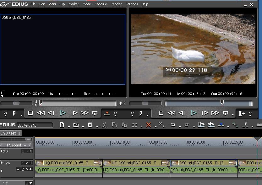

              Test config.
              i7-940 3GB
              XP-SP3 ...(german)
              Edius 5.12 ....as OHCI .....(german ==> with renamed "Localice" folder)
              clean NLE station, without internet \ codec-packs \ Nero \ other ugly stuff.....

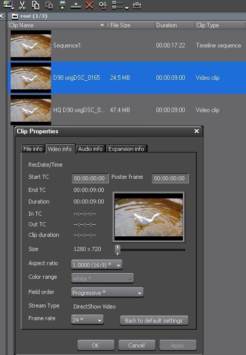

              File: DSC_0165.avi.......(25.109 KB)
              Filesource: http://www.dpreview.com/news/0809/08...plegallery.asp
              Results:
              • successfully play native D90.avi on timeline video + audio ==> puffer runs up to 70
              • successfully convert to HQ Online Quality ==> per Bin ==> contex on clip ==> "convert"
              • successfully play HQ converted D90.avi on timeline video + audio ==> puffer runs up to 280
              please, excuse the miserable english ....friendly greetings from ....CentralEurope
                Click to Enlarge....Click to Enlarge
                technical data from the "D90 testclip"
