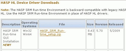

                        Question in representation for all (normal) editors, without big internet \ PC \ SW experience
                        is this the correct site: http://www.aladdin.com/support/hasp/....aspx#latestDD ??
                        is this the correct driver: HASP_SRM_Run- time_setup.zip ??
                        Version: 5.70
                        Released: 5/2009
                        a clear "yes" would imho help a lot of users, without big internet \ PC \ SW experience
                        friendly greetings from ....... CentralEurope
                          The unified runtime installer is the one to get. The 5.70 driver works correctly under vista 64.
                          I used this install recently to solve a problem on one of my systems.
