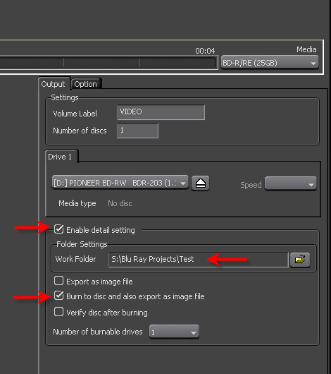

    in order to burn further copies, close Edius
    start/program files/edius/DVD burner... select the folder that has Video_TS
    the reason it saved to docs and settings and was slow is because you forgot to set the path to the working folder in advanced settings
      Thank you Anton. I have corrected the folder location. It still seems to be going slow, but I am on a USB external. Now I can figure out how to burn again without encoding.
      In the meantime, I'm installing Edius on my main machine that's in my signature. I should have done that days ago.

                  Hi Scott
                  are you using 5.11?
                  see attached
