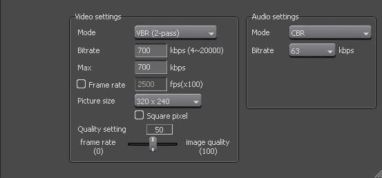

        My Project was started with SD PAL 4:3. (Please see attached pic)
        did you make any changes inside enable conversion to the source settings? or did you only modify the destination settings?
        As my client specifically required 700kbps of bitrate, thus i only changed the bit rate from 500 to 700kbps as shown below;
        there is usually no need to make changes to the source, if you do, it will export slower time required to export to wmv CBR one pass at 700kbps from a standard def 60 min timeline on my system is 8 minutes (there is no need to export the timeline to an intermediate file first)
        Perhaps this may be the cause of my conversion slowdown but nonetheless, if yours can encode under CBR one pass @ 700kbps, I still cannot believed mine had took me so much longer time in terms of hours just for a 2hrs footage ????
        For info, my RAW file placed on Edius 5 was m2p. My system consists of Dual Xeon 3GHz CPU on Iwill DJ800 MB, 4GB DDR2 Rams, nvidia Quadro 3500 Graphic Card, 2TB SATA II Harddisk, E-MU 1820m Sound Card, Canopus NX(PCI-X) card with HD Breakout Box, Canopus Firecoder (PCIe) card, Adaptec 1420s Sata II Raid card, XP Pro SP2(32bit).......
        Could it be the Mode (VBR) i used instead of (CBR) ? Or does the 'Rendering Format: Canopus HQ Format' plays a part here for the slowdown??

                  I tried use CBR instead of VBR....it only takes about 1hr 30mins to finish that 120mins clip.....Better than the VBR which commands a longer encoding time...Sincerely thanks for your Help...Cheers...
