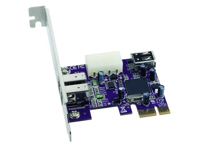

          An issue experienced by some was Firewire bus dropouts when using FW800 ports with ADVC units. These were fixed completely by buying a cheap FW400 PCI card (you can get them for around $10 these days).
          I don’t know what kind of firewire card I have in my Dell. It came with the computer. I’ll find out and post back. I do have a spare firewire/USB combo card laying around. Should I try installing and trying that out? As to FW400 card you are referring to, is the link below an example of the card type?
          Buy SoNNeT Allegro FireWire PCIe Card (2 ports) Model FW400-E with fast shipping and top-rated customer service. Once you know, you Newegg!
              http://www.newegg.com/Product/Produc...82E16815104003
              No I was thinking of something more like this: http://www.newegg.com/Product/Produc...82E16815282002, but this assumes your computer has PCI slots (the one you looked at was for PCI-Express slot). You will find even cheaper ones at that site. But if you confirm that your Dell has FW800 ports and you have exhausted all other possibilities, then I would definitely try your FW/USB card first.
